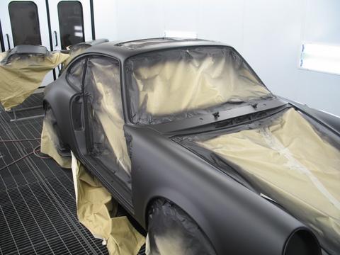

this picture is first base coat pre block sand...
Looks like a nice facility for the respray.
Who's doing it ?
Looking nice already, bet you can't wait.

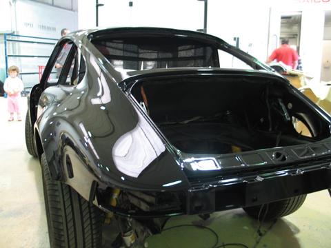

yes it's about a month or so old - Lancaster Porsche Cambridge...was a bit more expensive but comes with a lifetime guarantee...I'm not planning on selling the car so it also seemed like a worthwile investment...I'm well chuffed with the service, They have put a huge amount of effort into the car and always ring me at each milestone so I can pop round to take some pictures...This one is after lacquer pre polish - I'm starting to lose sleep because I am so excited...
Alex, that is more money than I paid for my car 9 years ago. You must really like that car! They are great cars.
Make sure you get an agreed value insurance policy just in case though.
