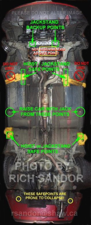

Just for the record I don't think those nipple featrues at the front are for jacking at all under any circumstances. I think they are locating features for the stand the shell was suspended in on the production line. The only jacking points are inboard of the nipples where the square section tube blends into the floorpan for the rubber covered domed dish shaped pads you get on garage jacks. Other than that is it the normal jacking point in the middle of the sill. I've got a good underside photo on my computer at work illustrating all the jacking points and it specifically says never to use the nipples for jacking!!
Found the underside photo highlighting jacking points and more importantly where not to jack.
