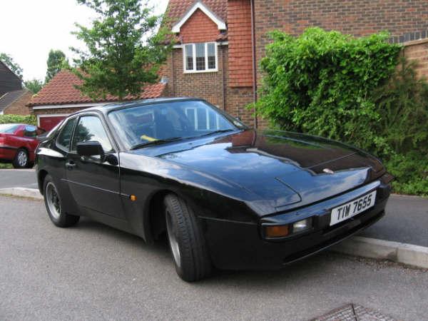

I am going to look at a '83' 2.5 lux tomorrow eve
Long story short it has done 112K and has been well looked after, its a friend of a friends car and he thinks the head gasket has gone ? it now wont start ? He is not mechanically minded and is just guessing .
He wants it gone soon as he has another car now and said i can have it for £500. I am very handy with a spanner and feel like taking this on as a winter project in my garage as i wont get much use out of my bike for the next few months.
What should i look out for as a general rule of thumb on these, and does it seem like a good buy ?

For £500 I don't think you can go wrong, even if the engine is beyond repair the car's probably worth near that for parts [:D]
If you get a chance to look over the car & work out what's likely to need replacing get some quotes on the parts before you buy. Porsche specific parts can be expensive, even second-hand. Go in with your eyes open [;)]

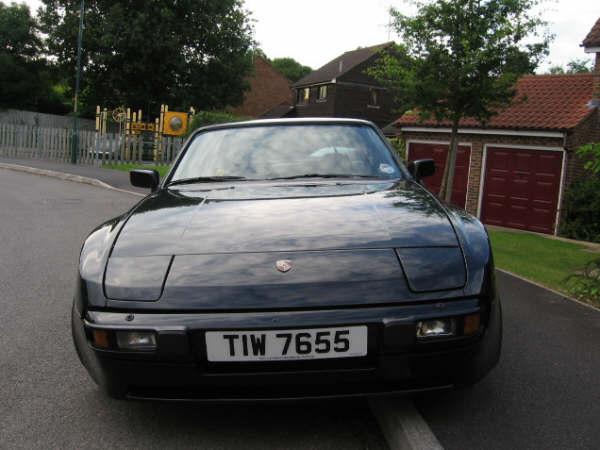

Well had a good look over it, looks like headgasket as there is little water in the header tank and it cranks over a bit fast, sounds low on compression. The owner said that the previous owner had fitted a manual fan switch as it used to get a bit hot, the current owner had always used it for long or short runs so it either didnt get hot hot, or was just cruising up the motorway.
He then got stuck in a field, (long story) and was revving it to get out when he noticed the temp gauge had gone up, he then switched the fan on but it seems the damaged had been done as it cut out and hasnt started since.
Where is the best place to buy a headgasket set from, and do these heads tend to crack ? i will have it skimmed and pressure tested but i would like to start looking for a back up head incase its fooked.
All in all car is very tidy with just a tiny bit of surface rust on the rear arches.

nice looking car rd944 !
