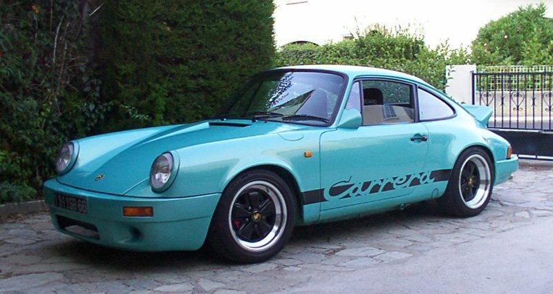

And finally, so that RB doesn't wear out his copy of the picture, this is how I would like mine to look :-
