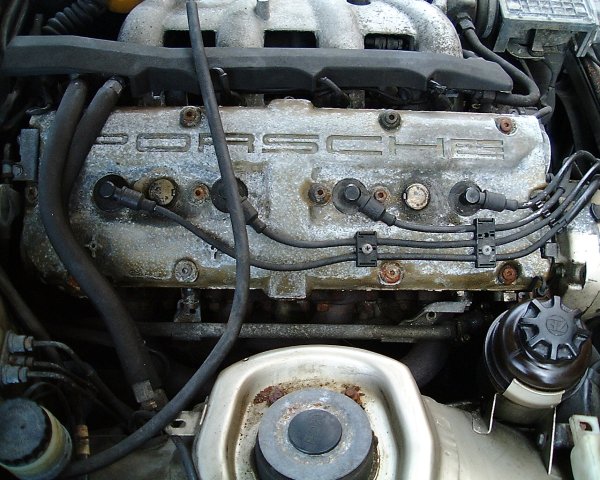

How far off being completed is your car as I can't wait to see the engine bay. This is one area that is slighty disappointing about my S2. There seems to have been a lot of condensation forming in the past that has sent some things under the bonnet rusty or covered in a white powdery coating.
Possibly the scabbiest cam cover ever?
Phil
Jeez - that isn't pretty, is it? I'm sure it would come up with some elbow grease applied in situ, or a removal and powdercoat or polish job would fix it.

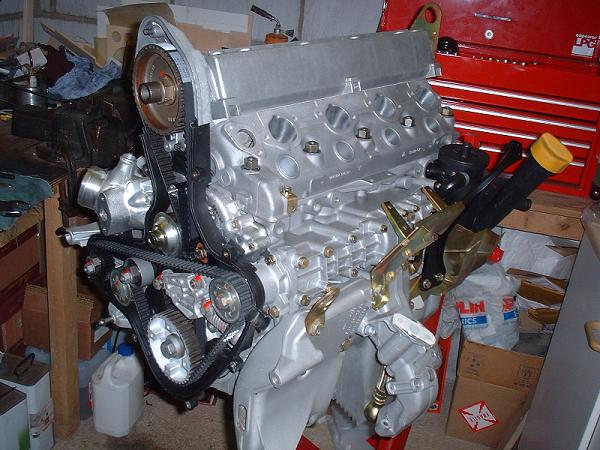

I've never seen an S2 cam cover look that bad [&:], a quick powdercoating in whatever colour takes your fancy would not cost more than £20. I once saw a guy buy a brand new one from Porsch-Apart in Bury for a very reasonable £40 and the original colour was grey. They all seem to fade to beige.
I 'may' have my car at Tipec next week, as the engine is being fitted from Monday onwards. Honestly though, there are so many unknown variables that I would not hold my breath (though I will reserve a Bournemouth Motel for Friday night so I can maybe collect her on Saturday).
Here is a pic of the fully assembled engine [:D]
Hang on, shouldn't ther be a transverse hole through the back of that? Or is that just mine? [&o]
