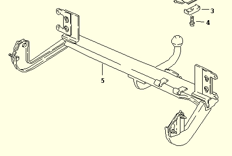

I found the following in PET - it is part number 944 722 901 00

My car has the remains of a towbar and electrics but those remains dont seem to equate with the towbar as shown in the PET and looking at the PET, I can see no reason to cut the diffuser as mine is!

No idea if anything has been replaced (bumper etc) but the PET drawing looks like it would fit under the bumper and guessing over the diffuser, would make a mess of a toast rack!
I can confirm that a good section of a toast rack has to be removed to facilitate a towbar.
Mine previously had one and the bracket etc are still there and as I have the toast rack off at the minute I can post up a picture tomorrow of exactly how much needs removed and the postion etc [;)]
