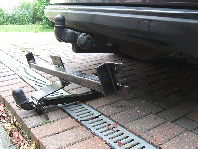

Guys, You are aware there are two types of towbar?
The one shown is for late cars, with the Turbo style valance (it also has a brace which goes to the underside of the spare wheel well. There is another which is for early cars... Either will fit one either car, it just means the valence doesn't... Stupidly, I had a late towbar on my early car, and now have an early towbar on my S2. I have now aquired a proper S2 towbar for my S2, so at some stage will find out if it does fit without hacking up the valance. At the moment, the right hand half of the valance has been left off.
I doubt the early towbar would clear a toastrack spoiler though.

I do have the S2 one here, as well as the early type fitted to teh car, so I'll see if I can get a picture taken tomorrow.

Attached promised picture... The S2 towbar is on the ground, the early 944 towbar fitted to the car (S2 missing large half of valence). the difference is the flat plate goes down to meet the wheel-well stay on the early towbar, where as the stay rises up to meet the flat plate on the S2 version.
Thanks Tref, that makes it much clearer, will speak to llocal trailer centre re price
