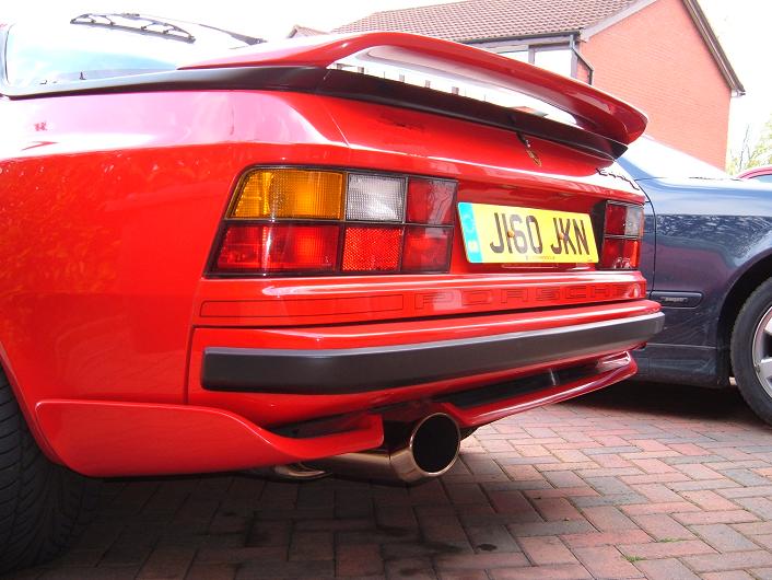

That's Essential Styling who had their exhaust designed by Janspeed a few years ago. Unless something has changed while I wasn't paying attention then that will be the same exhaust and it's fine. Lots of people on here have them. Another option is Hayward & Scott who used to be more proactive than they seem to be of late in the market, but whos system I have personaly experience of.
Your '86 probably doesn't have a cat. I'd say it's not 100% certain but probably 95% safe assumption however. It doesn't matter though as there is still a join in the system at the same place.
You won't get a lot of noise out of a Turbo without a custom system designed to be noisy, and if your car has no cat it will have a silencer instead so you quite possibly won't notice much difference at all with an off-the-shelf cat-back. My H&S was deeper sounding than standard but not a lot louder (but it was a full system). Having heard a noisy one I'd have to say it isn't a nice noise anyway, which you'd expect as it's just a fairly uninspiring 4 cylinder engine at the end of the day.
I had one fitted to my S2 few years back , bought it from ESS if I recall correctly , Had the Oval type and it was great , love the engine note and I do believe the exhaust made the S2 go faster , If I recall correctly I only paid 4years ago around the £295 ish mark and things get cheaper , just checked on essentialstyling.co.uk and the same exhaust is slightly cheaper , well recommended manufactured by Jan Speed very top quality , best regards J

The ESS front section is larger diameter than standard - especially the section that is 'squashed' on a standard car. Not sure about the rear, however Janspeed initially started without a front box and then fitted one (of a straight through design) and found more power in back to back testing. I had asked Simon to ensure it wasnt to loud for trackdays.
