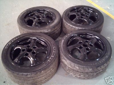

OOps I seem to have bought myself a 3rd set of wheels already equipped with Kumho road legal track tyres (235 up front, 275 at rear). Picking them up on Saturday
Sorry for the Off Topic [8|]
Nice! Love the black wheels. What size are the rims? They look the same as Beaky but I'm only running 215s and 255s.
They are the same Boxster twist design but they are 9" all round as opposed to 7" front and 8.5" rear like Beaky (and LIL) currently have. I'll see what the 9" are like up front and maybe swap them for my 8.5" and paint em black to match [8|]
Have you only got 8½" at the back then, not 9" like Beaky [;)] Size matters.
I wouldn't think 8½ or 9 would work at the front but it will be interesting to find out. I seem to recall someone fitted the wheels at the wrong end after a track day and said the car felt horrible.
IIRC Rock Connoll has 245's on 8" rims at the front of WUF.
Yes that was Pete Crosthwaite after one of the Goldtrack Silverstone evenings, only he then had 255s at the front and 225s at the rear, what was worse is they were directional and by the time he got home he had totally arsed up the tread [:mad:]
