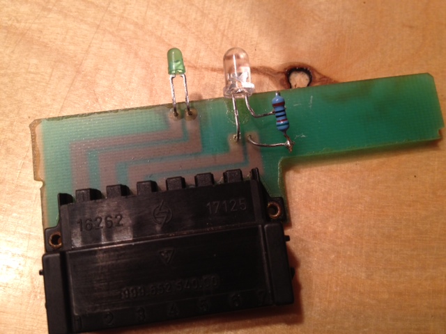

I tried a 3mm yellow first of all and concur that they underperform so whilst the kids are in bed this is what I've come up with as an alt...
I used an Ultrabright 'warm' white 5mm LED and soldered a 520OHM axial resistor into one of the LED legs. The PDAS is a 3mm 12v Green LED. There's room inside the switch to accommodate the resistor soldered on in this way.
One tip I would recommend is flattening off the tip of the LED with 1000/2000 wet and dry. The flattened off head diffuses the light slightly better and helps illuminate the edges. Once you have flattened it off, give it a good polish.
The results are really good and the warm white LED keeps it looking original and 'analogue' albeit 5x brighter...
