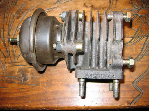

Pauls old wastegate from an earlier post. (eventually)

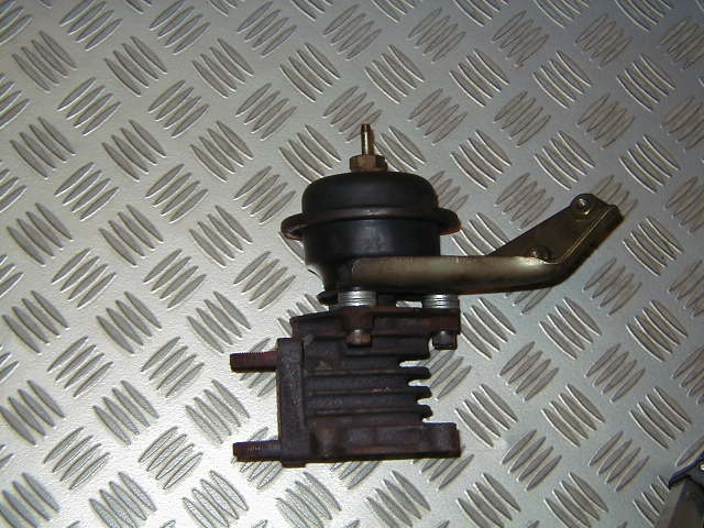

Here is another picture.
This one has got about 4k miles. The part number is visible.
Good job i asked first as this isnt the part i need,the problem is i am new to turbo ownership and dont know what the part is i need,i described it and i was told that is sound like the wastegate but the part on my car doesnt look anything like.The part i need comes off the exhaust down pipe to the main pipe and is towards the o/s of the car at the side of the starter motor. I have a picture of the part i need but i can,t upload it. can anyone help !!

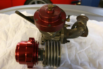

To be honest this sounds like the wastegate to me. Is it possible you've got a dual port wastegate fitted. Tial and Lindsey are the most common and are pictured below (courtesy of Rick). They wont necessarily be red in colour, my tial is silver and I,ve seen blue before.
HTH

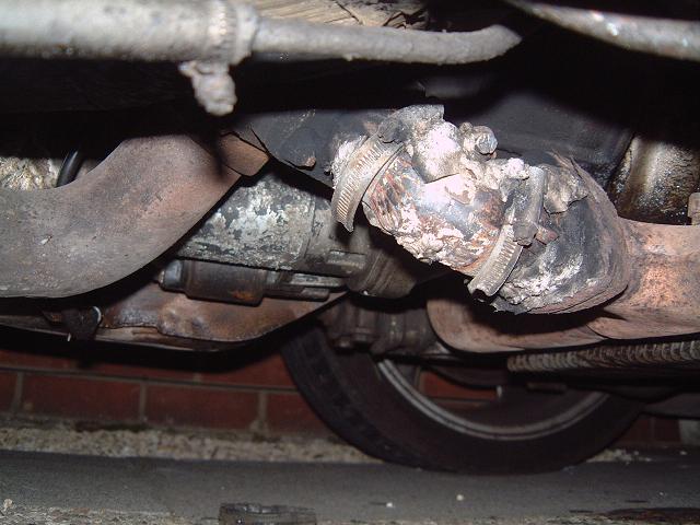

Is this where you have a leak? From description on previous threads I thought we diagnosed (as far as possible without pictures) that it was the pipe the wastegate vents back into the exhaust system through.
It looks like the pipe that is on the right of the wastegate at the top that is leaking,well when i say leaking its been very badly welded and has metal clips holding it on (would be better if it didnt have one at all !!)I have sent chris a picture which he has kindly offered to post form me so hopfully we can see what i need.
ORIGINAL: Fen
You mean that bit made of snot and jubilee clamps? It isn't meant to look like that!
Yep thats the part,no wonder its blowing, i got a bit of a shock myself when i first saw it !!!. So what is it then ??
It looks to me like the exhaust inlet to the wastegate, I'm no expert though so will stand to be corrected. According to PET the part no is 951 123 027 01. but I would seek confirmation before ordering.
That sounds like it could be the part,it does look like the pipe on the wastegate at the top of your picture, ive never been under the car properly yet so i dont know what type of gate it has fitted !!!
Thats it. The top wastegate in the picture is the Lindsey which basically reuses the lower half of the original wastegate. so yours could be a lindsey wastegate but going by the state of the pipe is almost certainly original[;)]

First on a standard wastegate:
http://www.porscheclubgbforum.com/upfiles/14/Wu604840070.jpg

I'd try the usual breakers to find a replacement for your, erm, thingy with clips on it [:eek:]
Thanks for the pics ,i have had a look under the car and its the same as the first pic (standard gate),chris the part number is correct so now i know which part i need has anyone got one ???
