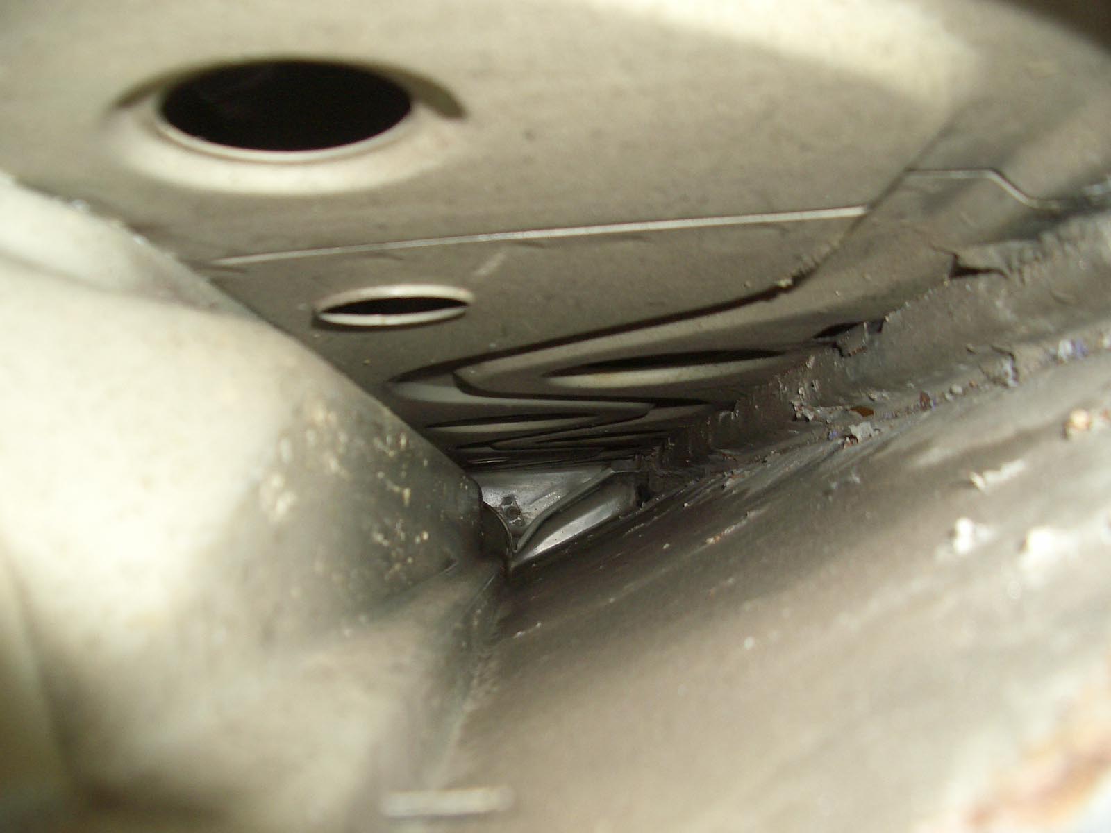

How about a picture of how they should look - this is the passenger side, taken from the back with the end being at the front.

We use boroscope cameras at work which are cracking pieces of kit. I've been trying to borrow one to take a look at all the various nooks and crannies like the inside of my sills and even poking the scope down the spark plug hole to see the condition of the cylinder bores. However you're talking about £15k for the kit!! I have seen some more basic pieces of kit for use on cars but they are still pretty pricey. Would be a nice piece of kit though.
I have a couple of tiny bullet cameras that I use to take trackday footage. I wonder if they are small enough to fit down there? The only problem I see is getting good illumination - I'll give it a try at the weekend.
I managed to feed a bog standard digital camera through the vent hole in the b-pillar, lower it to the bottom and operate it with my spare hand. The standard flash gave results very similar to Carl's post above, though err..my sills aren't quite so pristine[:eek:] even though they look it externally.
