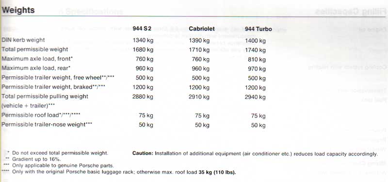

According to the manual kerb weight is 1310kg
There are four sets of figures on the VIN
1650kg
2850kg
1. 0740kg
2. 0930kg
Not sure what these are?

My manual says 1350 Kg as well.

Why would one manual say 1310kg and the other 1340 kg for the S2. Were revisions made to the car in later years of manufacture? My 89 says 1310kg (Non Cat).
I think you've just answered your own question! the addition of a CAT alone would add a good few kilos, plus the standard options might have changed in 1990. I know there were revisions in the supension at that time too, so that could add up to more. Maybe there were more options avaliable too, so adjusted the figures to an average that reflected that. All that aircon, stereo upgrades and elec seats add up to a big gain in weight!
