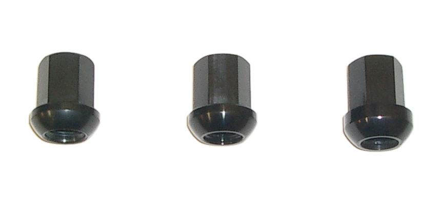

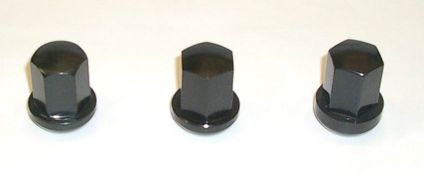

I have taken a couple of pics so you can see (hopefully) the difference in the 3 black nuts we stock. from left to right, aftermarket, OEM, superior
I think you should be able to see the aftermarket one has been nicely finished, smooth edges and no machine marks, the OEM one has sharper edges and isnt as clean looking
The radius bottom is the same on all 3, the superior version does have a slightly longer step down before the radius starts making it a couple of mm taller than the other 2
