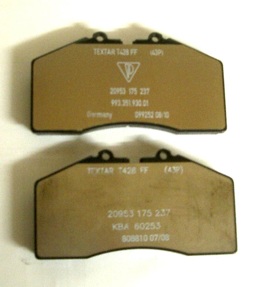

I should perhaps have qualified that my earlier comment regarding Textar pads related to the 993 only. Textar confirmed that the specification of 993 pads packaged as "Textar" and those packaged as "Porsche" where exactly the same, including the use of the same friction material. This was a couple of years ago and they may have changed their working pratices since then, I don't know and I don't care as I use Pagid or EBC. And yes I do know that this contradicts my earlier statement that I would always go for Genuine parts [:)] [:)]

Photo below of Texar 993 front pads and Porsche Genuine ones, as you can see, all numbers, compounds etc and indeed the same!
