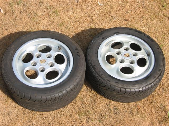

My '87 late offset car had 16" teledials and they were deep dish. I sold them though because I thought they look dated and wouldn't fit over my Big Blacks. They were deep dish though though the photo attached doesn't show how deep very well.
