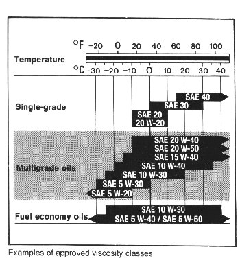

This is a close approximation to what is in the 944 handbook would guess the 968 one has something similar- even then (1990) it has 5W listed. When I spoke to mobil (about 2 years ago) they recommended Motorsport, but as I say with the latest runny stuff (tri synth) it stays in better than the earlier runny stuff (similar consumption to motorsport in my car)
