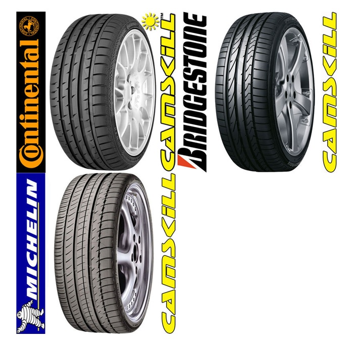

Many active Turbos here use Bridgestones , which are, of course, also 4WD. Some people like Michelin Pilot Sport which probably offer slightly better performance, but have quicker wear characteristic too. Some say Continentals are very good in the wet. Pirellis don't appear that popular in 997 Register, but having said that, there'll probably be loads of bods along now saying they swear by them. [8|]
Probably the best tyre currently available is the Michelin Pilot SuperSport, a relatively new product and unfortunately not Porsche 'N' rated for 19" rims atm; although it is 'N' rated 20" wheels on 991's.
Those old tyres on your car won't provide tremendous grip, but will be good enough for you to get used to the car. I would run those until you feel comfortable in the car then look at it again.

I had Bridgestone on my 997.1 C4S and just changed them to Pirellis P Zero (just under £900 for the set). The biggest thing I noticed was the Pirellis are much quieter than the Bridgestone were on the road.
Thanks for your comments. I've always liked Pirellis and the PZeros should look appropriate. I've got Bridgestones on an Audi Q3 quattro and whilst I cannot criticise their performance in the wet they do look very ordinary, not purposeful. I appreciate performance comes first but if the tyres match the car in looks then that is a bonus.
I've never found any tyre that I would call good looking! Side on they all look pretty much the same? Unlike the others the Bridgestones do offer some protection to your (good looking) rims[;)]
I had Bridgestone on all my 4WD 997's and thought them a good tyre. As I recall they all had the rim protector which is a handy first line of defence against minor scuffs. Wear I found pretty good and there is plenty of road noise generally with 997 but I couldn't say whether or not Bridgestone exacerbated the problem.
As far as I am aware the main issue with ageing of tyres is that the rubber compound hardens and therefore in many circumstances offers less grip. Assuming you are picking your car up in the next few weeks and that you live in UK, the tyre performance will also fall off as temperatures go down. This too reduces grip. If you do decide to get a few more miles out of the Bridgestones I would just keep in mind that their performance might be sub optimal.
Though perhaps not entirely relevant I have just bought a 25 year old 911. As part of the discussions I said that if the tyres were more than 4 years old I wanted new ones fitted. It arrived with new tyres.
Thanks guys for all your observations. As I don't intend using the car until next April I'll consider matters further and check prices. At the moment I am favouring Mitchelin Pilot Sport and Continental Conti Sport. I think you have now directed me in the right direction. Just by way of explanation, when I mentioned the look of the tyre I was refering to the cut of the tread. It may be me alone but I find some suit sports cars while others are more in line with family cars. Just my take on things. Thanks again.
