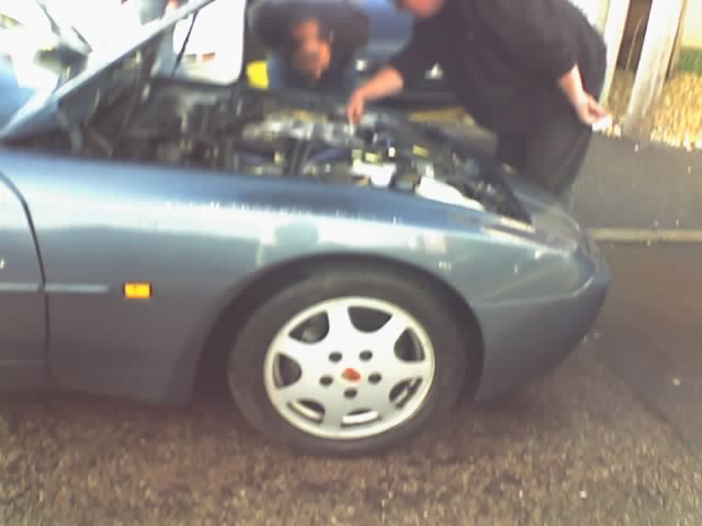

that pic shows them moving but its a pic so you cant tell [;)] is the lack of sleep starting to show?
