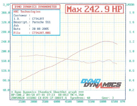

AFRs are the air-fuel ratio and would have been on a separate sheet to the dyno plot. Alan couldn't get mine last time as the twin out mufflers make it difficult to get sufficient flow over the probe. I would need it to be screwed into the O2 sensor bung next time. I plan to get the dyno work done at Weltmeister probably though Parr are much closer to me (but more expensive). The chip is going to be done by a secret source and if that doesn't work then I can send the AFRs to Steve Wong and he will burn me a chip. I was going to use Wayne Schofield but he struggled to agree a date to come to London - despite the commitment of 4 cars and a days work.

I thought AFR might be that, Weltmeister said it was a bit rich at the top end, 5500rpm, it use to rev to 7000 rpm when I got it but I have changed the rotor arm to a lower cut-off rpm. a bit chicken really !!. I really need to get 4 wheel alignment done next as I have fiddled around with the suspension and put 17" wheels on it. car likes left hand bends but doesn't like right handers. Is this the AFR graph attached below. Will your car be up and running or do you have to put it back together.

That looks like your AFR and that's all you need to send Steve Wong to get a chip burnt. He will have a few other questions but that's about it.

I too had a reply from SW as I asked how much a custom chip would be. He needs my AFR to do it properly, but has offered to burn one based on 'average AFR'. My dyno sheet only shows BHP and Torque.
I rang Alan at Weltmeister and he has the files on their computer. Quoted the Reg No. and he will print and post me the file (not Windows format so cannot e-mail) - great service.
