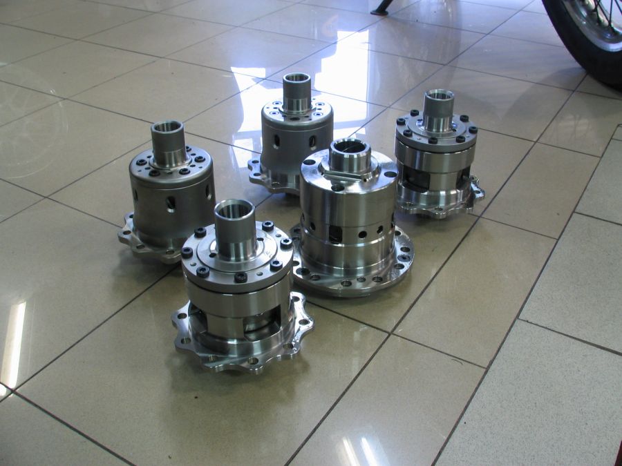

Another advantage of the 968 box over the 951 is that the LSD unit you can fit is larger and there is potential to use a 6 clutch one vs 4 clutch. I am going to try the KAAZ unit.
Another advantage again is its a separate unit so you can swap out the LSD without stripping the whole gearbox apart.

The large Dalek in the middle is the 968 LSD.
