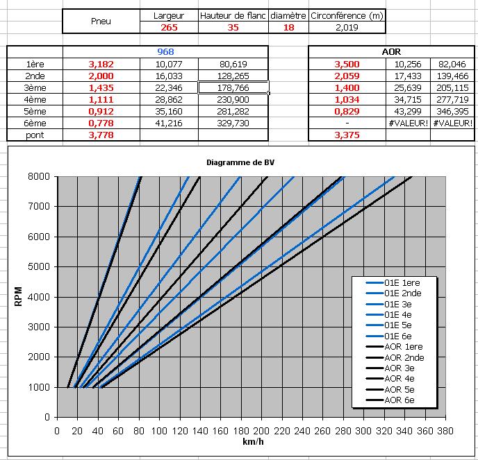

Well, this is the sort of Friday afternoon I will be happy to split hair over gearing calculations :)
With 265/35 18" rear tyres my Excel chart returns 7500 rpm at 310kph (~193mph) with 968 NA gearing.
What rear tyres size do you use?

Actually Thom I agree. I make 190mph at 7200 on my chart w 26" tyres. I was looking at the wrong one. I can't seem to get them to upload. Must need to convert the pdfs into an xyz or something.
Where's a young person when you need them. [:D]
