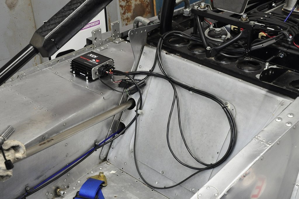

At very long last got to the end of all the wiring on this simple car. Takes ages and ages to do.
The XDi controller is wired and in place, about the driest space I can imaging in this far from sealed car.
Getting the pins into the large multi wire block was a real pain all refusing to simply push home. Had to open the whole connector up and do them. Hate it.
Made a splash shield in ABS sheet velco'd to the unit. The unit is a heat sink, so air much freely pass around the exterior.
The controller has to get to ground, power is needed (3 power lines) so they have to be 'enabled' only when the full ignition /fuel pump circuit is live. The kill toggle switch then shuts off power to the ignition and fuel simultaneously. They have to be individually fused too.
All the gauges have to get 12V prior to that status, but all done finally.

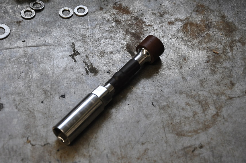

Went to remove the top set of plugs. Plug spanner too short, so mad one the correct length...

Put all6 top plugs back in with my new plug spanner and nipped them up.
