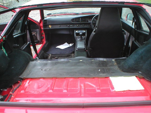

well just had a quick go at it now and lost a total of 55.9 kg easily (which includes taking out both existing seats and replacing with Cobra Monacos). Rear seats came out (only top half at the moment) spare wheel and jack and the rear seat belts and fasteners. so it's gettin there. Just waiting to hear about a roll cage best price so far iw £650 + vat + fitting so not great.
rear plastic screen is a possibility just have to price it up + the cost of fitting it. seats, harnesses and cage will be coming first though.

There's not much weight in the lower rear seat and it exposes messy glue which is a pain to remove. However as I'm sure you've noticed the rear carpet is heavy, so whip that out if you haven't already. I want to recommend going for a lighter battery but cannot as I'm still waiting for the parts to try mine, however for £130 ish you can save quite a bit there (and loose the need to vent gas and prevent the risk of any acid leaking).

yea I was quite pleased it lost a fairly significant amount of weight that easily but I suppose thats the easy part done!
how do I remove the sunroof motor? and do the clips just attach to the sunroof and roof of the car then just hinge up and lock?
seats were just short of 25kg each! so thats a pretty big saving. replacing side windows with plastic ones should be easy enough and I'll take the rear carpet out as it's pointless having it in really and as peter says it's pretty heavy. Ive had a quick browse on the plastics4performance website and it looks pretty good stuff.
