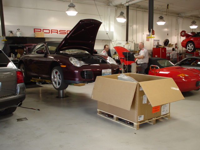

I was at my local dealer this morning and it was the first time I saw 'the box' and it was not an engine failure. Jeff

Come to California in April. If the tech session goes it will be very good as have the ones in the past. Here is a picture I took last week at a nearby dealer that is not my local dealer. Jeff
