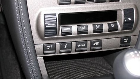

If they say it's going to be more than 3.3 hours tell them to read my Official PSE doc which states it shouldn't take more than 330TU (100TU=1hour).
Sounds to me though that they don't understand the difference between the 2 installs (sport and non-sport). With non-sport, there is an extra switch space available on the panel, so they fit a new button. This takes an extra 110TU to complete. When you already have Sport (and PASM) there are no free switch locations to have them fitted with so they tie PSE straight into the Sport button. Hence much quicker as they don't have to put in a new button.
The following (photoshoped) pic is NOT possible - i asked like a 1000 times!
