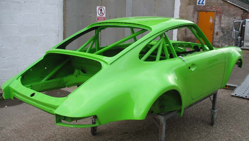

looks a nice cage, what class are you competing in ? Is the engine staying the same?
more importantly what colour is it going to be ?[8D]
Believe it's a Safety Devices cage. Haven't decided what competition to do but some ideas, not sure when it's going to be ready though. Also intend to use it for track days and talking about taking it over to the Nurburgring as I have never been.
Plan A ... standard 2.4 E engine ... Plan B ... more powerful engine but not until next year.
As for colour ... still undecided ... still leaning to silver though as original colour.
On to the jig at the weekend so more pictures in a couple of weeks. Also currently building up the list of parts to buy for it. Quite a lot will have to come from the US so that may delay things but worth waiting.
Ian.

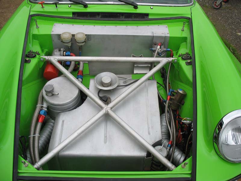

Nick, question for you. I saw a picture of the vivid green restoration you are doing and the front strut brace had what looked like additional bars welded between each end and the opposite front corner of the car. What is the benefit of this arrangement?
Ian.
triangulation
prevents 'twisting'. With a strut brace the shock towers can still 'twist'
good explanation here:
http://www.elephantracing.com/techtopic/triangulation.htm
I understand that set up. Nick's car had the extra bars going forward to the corner past the battery box so it was triangulated horizontally not vertically. That's what I can't see the benefit of.
I assume you are not planning to use the car in any MSA scrutinied (if spelt right) events ? If you are , you might need to look at the size and thickness of your roll cage mounts - all covered in the famous blue book. Looks like good work , wish I was at your stage with mine ! Good luck.
ORIGINAL: Cortina
Yes regs are 120sqcm main, 60sqcm rear brace. 3mm thick all bits. The rear brace and the front mount (not in yet) are the right size. The main rear foot mount is an old fitting and not technically big enough. Trying to find out if as it's in an old car it's OK or a bigger one needs fitting ... bit of a minefield.
Also may have to up the size of the pads attached to the rollcage itself but again regs seem vague if rollcage was approved before date x ...
Ian.
The aluminium triangulation is bolted in and would certainly improve the stiffness and crash protaction of the front of the car
Thanks for the picture Nick, it shows the design very clearly. Is anything similar done for the rear end?
Ian.
Onto the jig ...
Start with a large pile of bits and a set of plans. Think of it as trying to put together an IKEA flat pack or one of those executive logic puzzles you get from your gran at Christmas ... only much larger.
If we hadn't chosen the gearbox mounts as the starting point and picked up the turbo gearbox brackets instead of the standard car ones we probably would have finished relatively quickly.
As it was we spent the next hour wondering why all the front mounts were out by about an inch. It was as if the car had lost about an inch in the middle. After looking carefully for chain saw marks that might reveal a cut and shut or wondering if perhaps we had a special MWB model (medium wheel base) decided we should start again from the front this time. After the lightbulb moment of seeing the second set of gearbox brackets all became clear.
Here's some pictures of the car getting jigged up
There are a few more brackets to go on yet. It attaches to the car at seven points on each side - front torsion bar mount, front wishbone mount, top of the front towers, rear torsion bar mount, top of the rear towers, rear gearbox mount, rear engine mounts.
