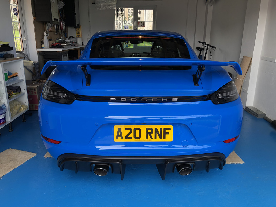

Back home - note the car's close but not quite right PTS against the sample floor.
I was pleased with the wheel colour, I had dithered over Silver for greater contrast but Platinum looks good. I should also say Topaz pdf + ceramic coating is miles better than the job Reep did on my old GT3.

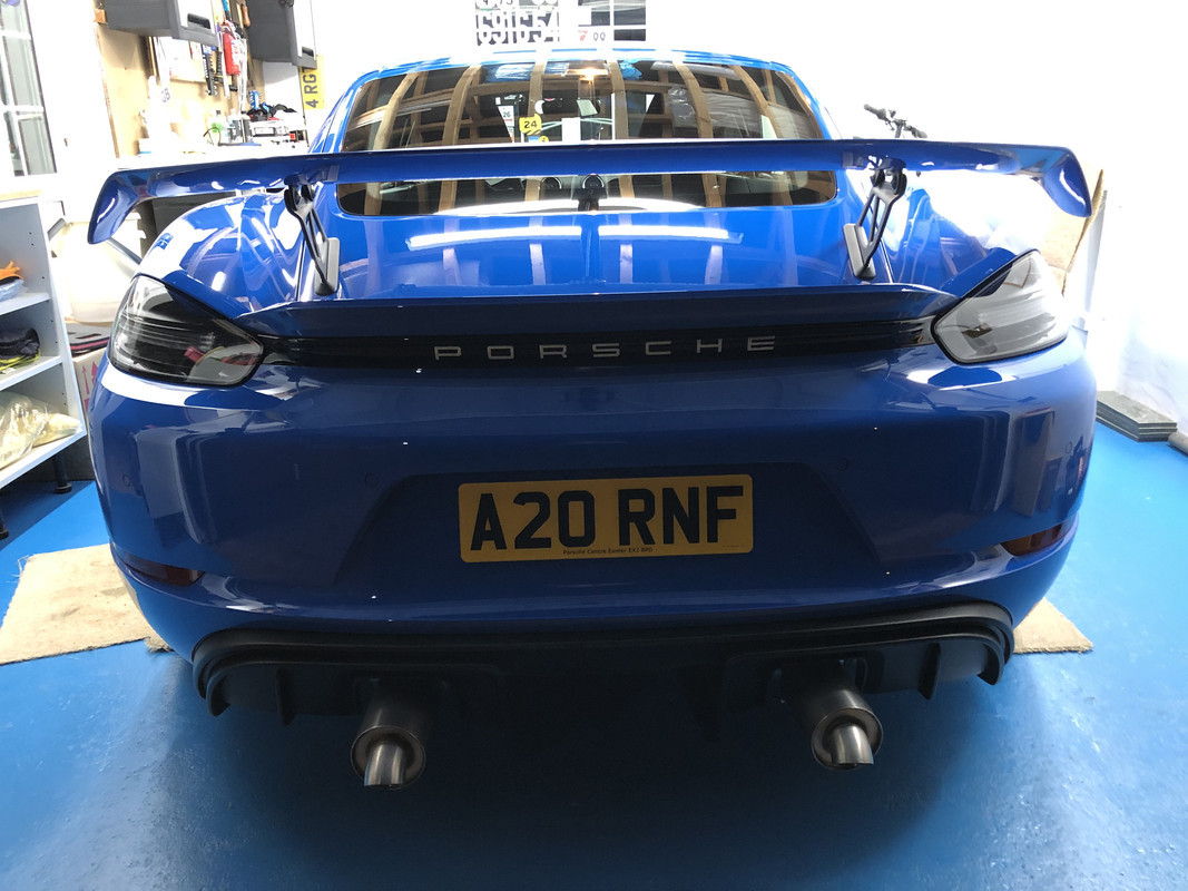

I've been setting up the car this afternoon with the main task of fitting the JCR tips.

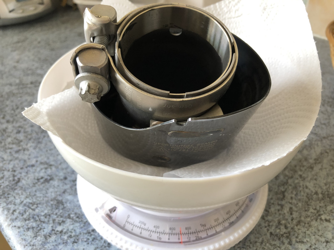

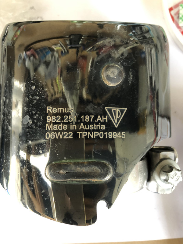

The JCR tips weigh 1.1kg, the OEM tips weigh 0.7kg, both are each tip
The OEM tips which are manufactured by Remus are secured with a 6 star #12 screw, the length of the stub tube on which the tips are fixed is 50mm.
The JCR tips are secured with #10 regular headed bolts and it is quite difficult to ensure the tips use the entire length of the 50mm stub tube. It took me three attempts to get each one securely seated and bolted up.
View of the tips from the rear
They remind me of the exhaust on a TVR. They also protrude further beyond the rear PU than the GT3 equivalent.
Off to Thruxton tomorrow to get a sound test courtesy of Javelin who are running a track day.
I suspect I shall feel nervous running these as a permanent fitment, mainly due to uncertainty as to whether they will stay secured. I did run the car for some time to get heat into the system and further tightened the bolts, time or tomorrow will tell. I will take them off for my first track day at Castle Combe on April 25 but put them back on for the back to back Goodwood and Thruxton May 4 & 5 track days.

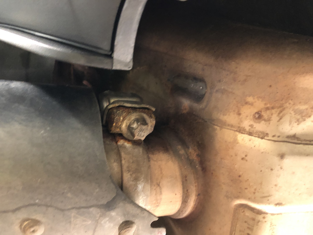

A reminder that exhaust fixings get very rusty - this was a 718 GT4 on the ramp at the Modified Register meeting at RPM last Saturday.
I'm thinking that lithium grease might be suitable to reduce the rust on exhaust bolts, any thoughts?
Complete Grease Guide - Workshop Greases UK (greasemonkeydirect.com)
For anti-seize - Copper grease ... slacken off fittings, apply where possible and remake
For anti-corrosion, wire brush externals and apply a thin coating of copper or aluminium grease
Ralph copper grease is good up to c 1000 degrees C, I use it on exhaust manifold studs/nuts etc on my old cars. Snowy

Those JCR tips look OK to me, even if you plan to keep them on all the time. 400gm extra mass and a slight increase in cantilever length shouldn’t pose too much of a problem, but best to keep a check on bolt tightness until you have confidence in the fitment.
The motorcycle fraternity like the corrosion-prevention properties of ACF-50 spray, so that could be worth a try.

JCR exhaust tips:
Good news, they didn't fall off.
Not so good news, the car tested at "93, nearer 94dB"
"not passed Sir but would you like to have a couple of laps to see if it is too loud as we normally allow some leeway on Porsches because all the noisy parts are at the back and drive by is less of a problem"
Puzzled because manual one was 92dB at Goodwood and Castle Combe.
A 4.0 GTS Cayman was 92.7dB and a 991.2 GT3 RS (@4k revs) with large diameter tips was 92.2dB and were allowed on for this 90dB static test day.
Anyway the plan is to leave them on for Castle Combe April 25 and see what they measure them at and then take them off and re-test with OEM tips - the noise tester there is helpful, as is the Thruxton guy.
Until then, getting some running in miles done.
