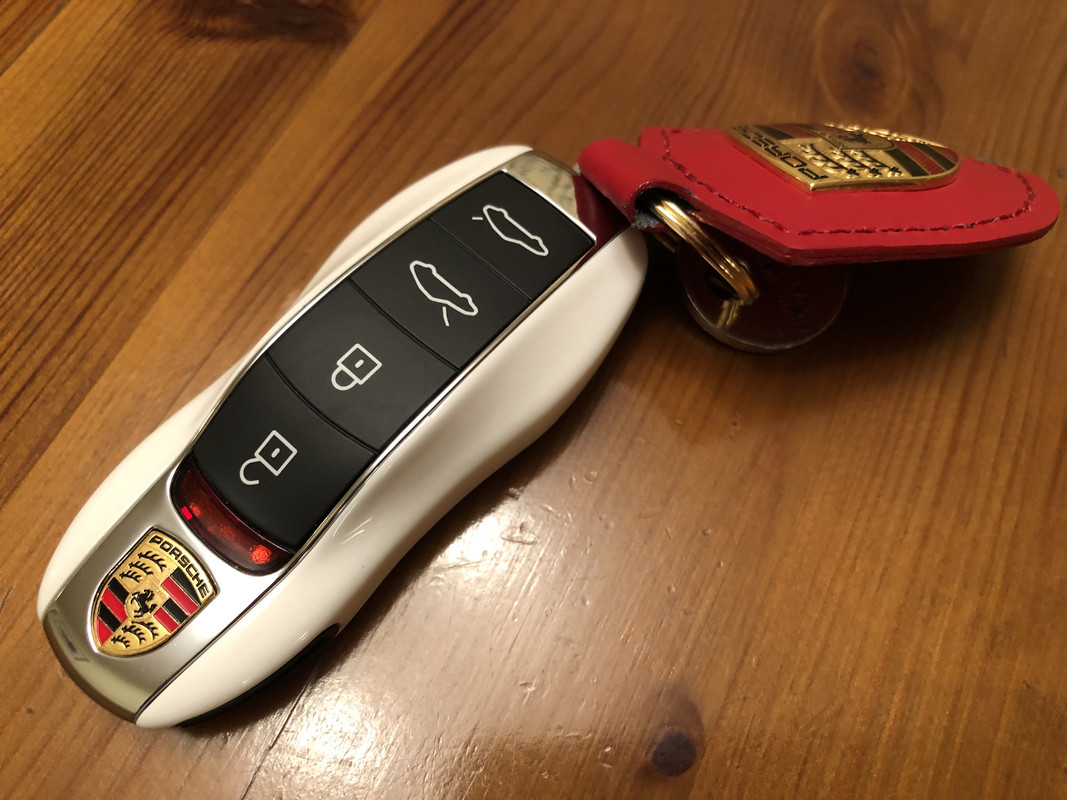

Being an inveterate modifier (and cheapskate), I have fitted my first non-standard parts, £17 from China versus £140 from Porsche (they are the correct white, different lighting)

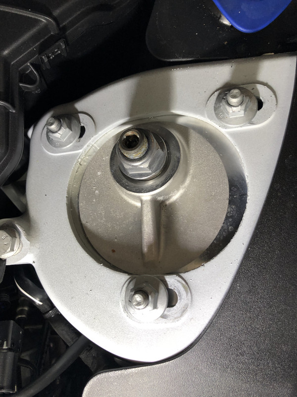

Interestingly the top mounts' camber is maxed out (near side pictured), so shims are required subject to constraints of the stock rear TCA. we're off to Centre Gravity before a January Silverstone track day (>1,700 miles by then) followed by an oil change and oil test a few days later.
![IMG_0043.jpg](https://i.postimg.cc/wTbdsXw1/IMG_0043.jpg)
Stock settings are:
Front total toe +2’ +/-2’
Rear total toe +10’ +/-2’
Front camber -1:30 +/-3’
Rear camber -1:30 +/-5’
