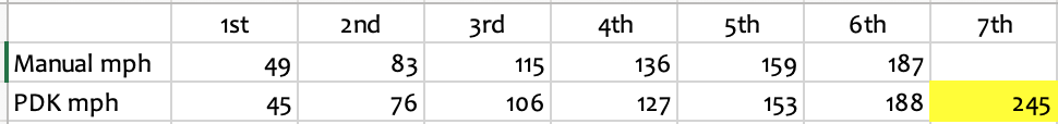

There was some interesting data on a German website recently covering gearing and in-gear acceleration of PDK v manual gearbox versions.
So the good news for those that don't like the manual gear ratios, maximum speeds in PDK in each gear, calculated using gearbox and final drive ratios and tyre circumference with my assumption on tyre growth at speed in 4th and above are below:
Obviously PDK 7th is theoretical.
It would appear that PDK is between 10% to 6% lower gearing thru 4th and this together with faster changes that don't unsettle the car in corners should yield benefits on more technical tracks.
Well done for sourcing that Ralph. One thing to take from the figures is that despite the naysayers banging on endlessly about the manual’s high gearing - 2nd gear in particular - the car’s still good for more than the UK legal limit with PDK! In real world driving, rather than the track, I can’t see there being a significant difference.

^ agreed Jeff. With a maximum difference of 9mph in gears 3 and 4 I don't see a whole lot of difference being apparent in the real world given the large in-gear spread both 'boxes have.
Interesting stuff though, Ralph - cheers!

Above 62 mph PDK is not faster, +weight, +10 Nm, -gear change time, or mainly manual at 125 mph being in meat of torque curve v PDK near max revs, if my table above is correct.
Just another take on Ralph’s figures comparing the delta speed in each gear, 1st-2nd; 2nd-3rd etc.
Man: 34 32 21 23 28
PDK: 31 30 21 26 35
Can’t see much difference there in the gearing, although subjectively I’m sure progress will feel more rapid with the PDK owing to the shorter gear-shift times.

10mph is massive at those speeds, you need a LOT more road to get 10mph faster at 100 mph. I am sure some one will do the maths. but you run out of road fast at these speeds, in fact it could add another 200 meters of road needed to rev it out in 3rd on the manuals.
My issue when I had my 996 GT3 and GT4 was running out of road space and thus never enjoying the engine :-( the extra 3 seconds it takes covers 220 meters !!! if it's 4 seconds that grows to 280 meters !!
the gearings **** no other word for it how ever you play it.

You are spot-on with that summary.
As a former hill-climb specialist in a previous life, I know only too well, just how big an effect a few mph of inter-gear speeds at max revs have on overall performance. I used to change the gear ratios on my racing Stiletto Imp's Jack Knight dog gearbox between hill climbs to gain vital seconds, not tenths, in competitive events.
Bringing this up to date, I noticed particularly at track days with my 718 CGTS PDK just how perfectly geared the ratios were for the power and torque curves of the engine. The difference in flow on the track was huge, and definitely not marginal. Even in normal road driving the closer, shorter ratios of the PDK made progress very satisfying indeed.

I don't think people realise, as they are in the main "lifestyle " cars. When you "drive" them on track or hard on the road the longer gearing shows it's ugly head and for me ruins the cars, been an issue even from 996 GT3 days.
And my fight from back in 2003 with the issue fell on death ears, it's only now jurno's moan about gearing lol !!! they are like sheep but no one said it in the 996/997 GT3 and it's the same in gear speeds all these years !!!
you post this on PH and people are happy milling about at 5k revs with the other half and nothing wrong in that of course. Porsche is the affordable "lifestyle" brand.
But owners always come back to me and say my 987 has long gearing and I get battered to death as no one ever agree's but the 9mph is massive, that's just maths.. So I give up with people some times. but as we both know 10mph and finding 300 meters of extra straight is impossible.

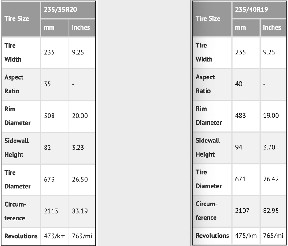

Just looking at whether 19" wheels would affect effective gearing. Given some can be specified with 19" or 20" wheels and aspect ratio to suit, these tables illustrate the very small difference in circumference.
The difference with the larger aspect ratio (40 v 35) will in principle be more flex in sidewalls.
