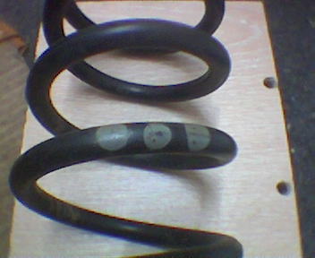

Any road up, according to PET there are 10 different springs for 944s marked:-
blue - 944
white - 944S
yellow - Turbo/944S M474
red - Pre 87 944 M030
white & blue - Post 87 944/944S M030
white & yellow Post 87 Turbo M030, & S2 M030, 89-90 Turbo
violet - S2
turquoise Post 89 S2
beige 90-91 S2
grey Post 90 Turbo
My second hand struts have grey markings which (apparently) means they are from a post 90 Turbo. Good start, but the plot thickens.....

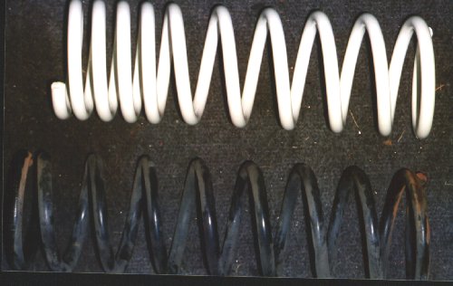

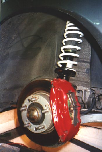

Just checked some old mails and the Techart springs I was originally supplied (S2 and early Turbo fitment were approx 110mm dia across from wire centre to centre I sold them to an S2 owner ('92model I think) who has them fitted.
The correct ones that fit my car, 1990 Turbo and 968s (according to the TUV documentation) are approx 95mm dia centre of wire to centre of wire.
I don't know if some S2's had the smaller diameter springs though - maybe they did.
Tony

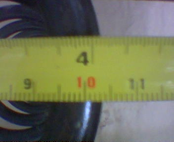

Thanks for that Tony & Fen,
Have measured the springs supplied by the breakers, they are approx 110mm dia which would tie up with Tony's wire centre to wire centre dim.
As my second hand springs are marked Grey, and should be off a late Turbo, I shall now interogate PET to see if there is any corrolation between 944 & 968 springs. Perhaps Tony has unusual front struts?

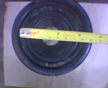

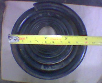

I remembered that my original springs were out in the garage measuring outside to outside is approx 104mm
centre to centre (or inside to outside as in the pic, its easier to measure) they are 93ish.
I don't think there is anything special about my dampers (struts), I replaced them at the same time as the springs, Euro car Parts supplied the incorrect ones, they were labelled with Porsche part numbers which when I checked PET where listed as S2, these were for larger diameter springs but on the euro car parts web site/catalogue were incorrectly listed as suitable for turbo. My OPC ordered the correct ones as listed on PET these had smaller diameter spring perches to match my springs. If you are interested I have the part numbers somewhere - they should be stamped on your damper units (struts).
