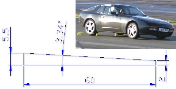

I attach below the photo that prompted this latest upgrade (thanks Rick, I think) and the calculations/assumptions made to establish the original angle of roll.
I have scaled the side closest to us based on 3" from the base of the tyre to the rim, as messured when standing. This is probably a little short as, under cornering, the inside back wheel isn't weighted. The 60" is the distance between the the bottom of the left and right body trims.

Will you be arranging for Rick to take the same photo from the same spot at Copse when the 944 Register visit Silverstone again in the summer? I look forward to seeing you get your slide rule out and calculate the difference in lean angle [:D]
You may well mock, but just wait untill I sail past you on the inside as you fight with that fine line that runs between getting round a bend and ending up in the Kitty Litter. (Which one of these smiley things is suposed to represent smug?)
