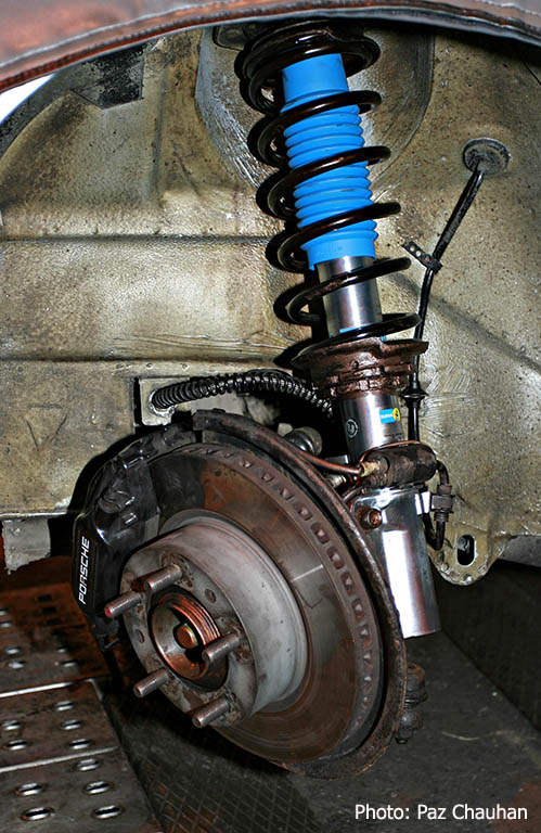

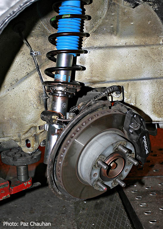

I've got some pics some where I'll dig them out and upload them
ORIGINAL: polar964
Hi Richard,
Apologies I stand corrected. There would appear to be 2 rings, now that I have looked. I was going from memory. Not to good hey!!
For some reason I thought there was the cup to hold the spring and then the ring, however there would appear to be a second ring.
Sorry for the size of file. However its good enough to confirm 2 rings!
Thank Paul, it looks like you have a different ring on yours, rather than just a flat ring it's more of a cup, which you'd use if the spring diameter is larger.

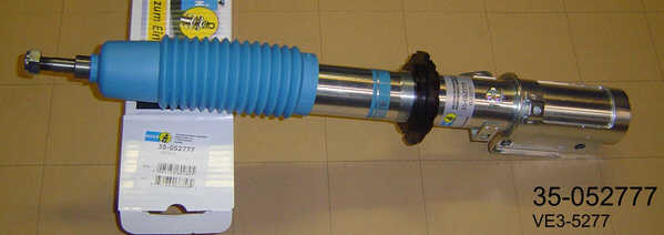

Here is a picture from the Bilstein catalogue which isn't clear but it does seem to show 1 ring?

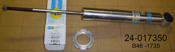

on the next post I've put a shot for the rear shock which definitely shows 1 support ring.
I don't think it really matters, as long as I've marked on it where the correct height is, if it slips which I don't think it will it can easilty be reset.
I think you'll find 2 rings are for the front as these will need locking because they are moving with the steering.
Whereas the rears only need one as they shouldn't be twisting (you're in serious trouble if they are) and rely on the downward pressure of the spring to hold them in place.
