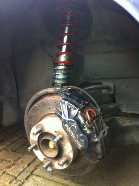

Well it's done and looking good.
I've gone with Eibach springs, with a main spring and tender. The tender means that the car has soft suspension initially then they compress and the main spring takes over under harder use.
I did speak to Chris for some advice on spring lengths and rates. Gone for 228lb front and 457lb rear. Chris was fantastic, he spent quite a lot of time on the phone with me and sent me some spring perches which he said to pay for if I end up using them.
Also put on a set of drilled discs I had sitting around and a set new of EBC yellows. Found a split CV boot whilst I was under there so changed that too.
Here it is now, what do you think ?
Richard, the helper spring compresses when the wheels are on the ground, its job is to ensure tension on the main spring at all times so it does not get misaligned..Height & stance looking good btw!
Hi ras62,
'helpers' and a 'tenders' are two different things.
As you have quite rightly said a helper spring is a flimsy affair, typically 20-30lbs and would usually be fully compressed, it just takes up the slack when the wheel is in full droop.
A tender spring is a proper spring, you use them so you can get different spring rates on the same shock. Progressive springs do the same job in a single spring but they are ultimately a compromise... a bit like mixing shampoo and conditioner in the same bottle...
Thats a good analogy, this link explains clearly
http://www.e30m3project.com/e30m3performance/tech_articles/susp-tech/springs/index.htm

Hi Bob,
Chris at Center Gravity helped come up with the springs rates, I wanted it firmish for track use but still compliant on the road, hence using the tender springs. I think I've got it about right but I won't know completely until I've done a track day.
The rates (and spring lengths) also took into account the dampers used so I'm not sure if they will suit the standard shocks. The other problem you'll have is the spring perches, the bits the springs sit against, they will be too big for the Eibachs as they are 60mm diameter the std ones are 70mm I think. I had to use some different top perches, you'll need different ones on the bottom too.
Chris at CG may be the best person to speak to, it would be easier to get some regular lowering springs for now as they'll fit straight on.
I bought mine direct from Eibach UK as they have the best stock.
Rich
