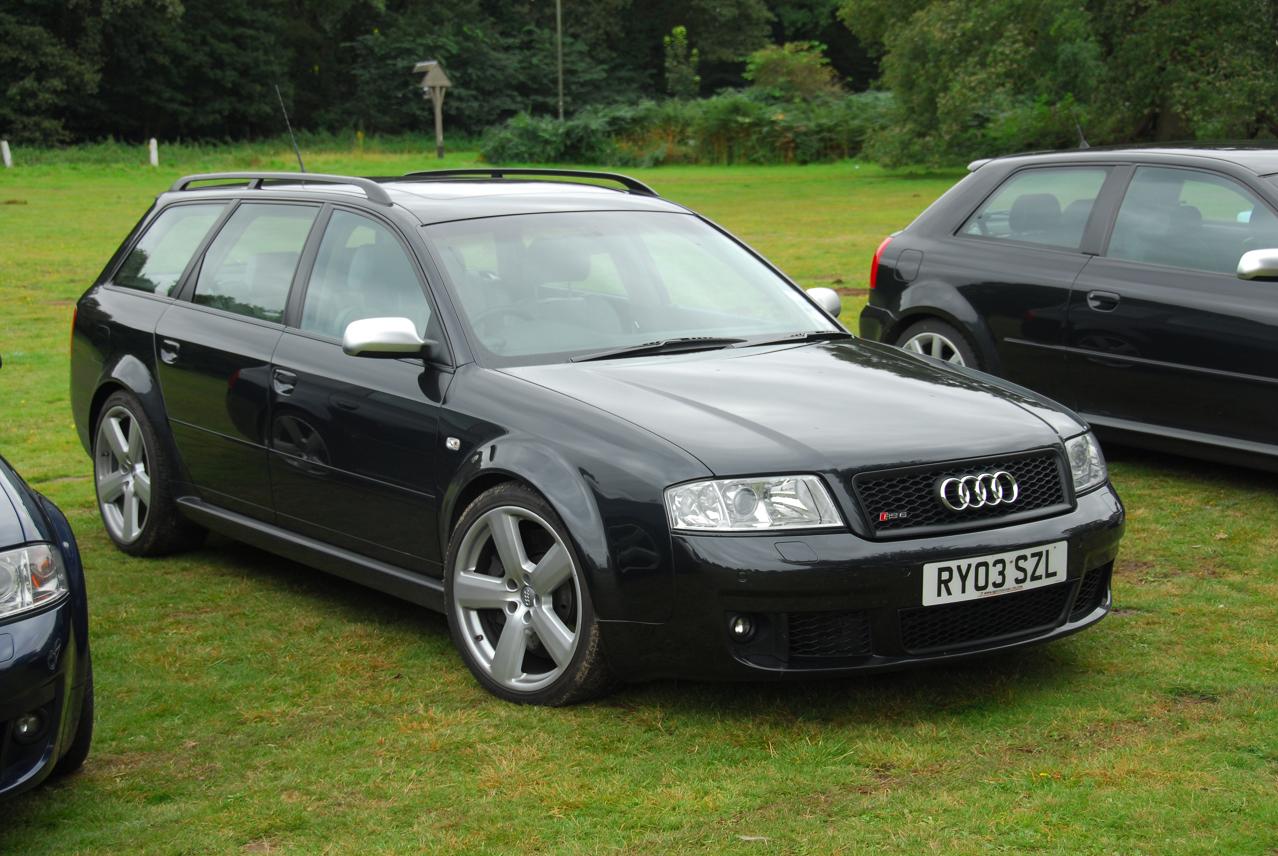

While you might be correct I believe the only cars I have had with one-shot windows have all been through the ECU. I can't remember if the appliance has one-shot or not as they have stopped working all together just now.
Yes, it's a pukka RS6:

I am wondering if all these controls on cars like your RS6 are on a Canbus. Everything seems to be going Canbus these days, I was having a play the other day with some Canbus test boards for a totally different type of vehicle, looks like fun playing with these.
