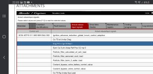

Following on from my last post and our focus on the technical GPF details on these cars, found this information regarding our oil ash issue.
What makes this information interesting is the mention of the oil ash load as a calculated reading.
We have never seen in the calculated reading K230 any recorded information at all.
Its always been recorded in the K231 section of the report, and when it gets to 100%, the light comes on and we have a problem.
This information is from the Porsche PIWIS coding information, found in the ENGINE OVER REV REPORT, ATTACHMENTS.
It clearly shows the Particle filter calculated oil ash load.
With an instruction to select values F12.
It also mentions the soot load.
This is very interesting and we need to look into this in more detail.

Well, I have a photo of the actual warning message, will let you see at the bottom of this post.
When this light comes on it can leave a DTC code P2463,(particulate filter soot load high).
When this code was checked we had in K211 soot load calculated 38.10 % and in measured K221 43.75 %.
We have never seen such high soot values in any of the cars we have dealt with todate.
More often than not we don't see any soot values at all.
I have just seen today a vehicle with 100% oil ash recorded, with zero soot recorded, and the usual very low differential pressure sensor reading.
The thing I don't understand is that if these filters are blocked with ash to 100%, why isn't the differential pressure sensor seeing a high backpressure and showing this on our reports.
These sensors can not distinguish between soot and ash combined, this sensor should look after the soot, like on every diesel car on the road.
The Ash reading comes from a measured value, measured from where ?.
Just a thought, if we removed the soot loading warning regeneration light function from every diesel car on the road tonight, the whole country would come to a grinding halt.
