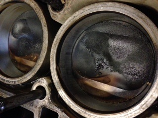

Does anybody know if it is necessary and therefoe where to go to fix scratches in the cylinder lining for a 944 turbo?
Soli, what are the suggested symptoms? Excessive oil usage? I think you need to provide more detail to gather a comprehensive response.
Sure. I bought a 1986 turbo a week and a half ago supposedly in mint condition. It looks like it on the outside. But on the way home engine got overheated and all of a sudden no water. Refilled it and managed to get back home without overheating. Next morning no water again and mayonnaise in oil. Got a rescue to the garage. They found a hole in the radiator. And obviously HG gone. And then scotch marks on the cylinder liner. Of course seller says it is my fault and that the overheating caused everything and there was nothing wrong with radiator. 3 experts tell me otherwise especially since there were problems with over boosting before I purchased which would cause exactly this issue. But never mind. Now I need a complete engine rebuilt which would be at least 3.5k+vat from the one place I found that can do this. I don't have the money as I spent it all on the "mint" car. So am a bit at a loss of what to do. The garage tells me this needs to be done and if I don't do it they want me to sign a form stating that it's not their responsibility what happens next to the engine as I didn't follow their recommendation. 2 garages told me it needs to be done. I am just trying to reduce the cost and the bad feeling I have really. Or I can just sell the car for parts and recover what I can

Soli, bad luck with the engine. The bore scoring could have been caused by the oil film breaking down as a result of overheating and possibly of the oil being degraded due to water contamination, not necessarily due to overboost issues. It is difficult to tell from the picture how bad it is, can you feel it with your fingernails? Is it one cylinder or all of them?

Is it me or does that bore look fine? That level of scoring on an alusil block won't do anything really.
Head gasket and a radiator then just enjoy it for the summer, take stock over winter but if everything has been fine then stop worrying and drive it some more.
That's my thoughts as well.
£3.5K to sort that scoring sounds more like building a race engine: I'd be living with it, or dropping one in from a scrapper.

Speak with jmg and harteck regarding the scored boars. There be able to give you idea off cost and time frame. Due to the niskal silicone coating it's not a simple job

That doesn't look too bad to me although not easy to see from the pictures, my S2 had scored bores probably from before I bought it and ran with no oil or water use for more than 6 years,
I do find Soli's garages insistence on signed disclaimers and push for him to shell out a huge amount of money for a rebuild that the car probably doesn't need somewhat unhelpful. Those bores don't look that bad and a full rebuild seems OTT to me. Just out of interest Soli who have you talked to about the problem so far I terms of garages/experts ?

My advice would be to have a new headgasket fitted and to ensure that the coolant IN was measured to the millilitre. Drive the car and evaluate it.
If it turns out that the (slightly) scored bores are an issue then speak to another garage. I would recommend EMC for both knowledge, ability and value. JMG and Hartech are both excellent, but Id expect them to be a good deal dearer.
