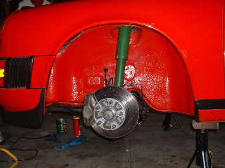

One of the USA Club Sport owners has sent me some pictures of his latest toys... Drilled Discs for his car, front and rear ! Furthermore, as he tracks the car, then I think we're going to get some "live and direct" experience from him.
If you want to know more about the experiences, then by all means drop me a mail
Piccies below..

Here goes, I have drill discs fitted to my 3.2 (front and rear) and have had of the last 4 years ! Unfortunately were fitted when I bought the car so can't really provide you with a constructive comparison. Suffice to say they have done 20k on the car since I bought it and 3 track days. I've not suffered any problems with warping or cracking..... touch wood..... ! By the look of them, I think the holes are cast in rather than drilled, I don't have a reciept for them so have no idea exactly what make they are.
