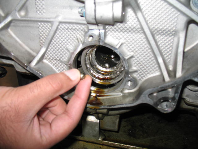

so going back to the shaft bearing issue, am i right in saying that a 2000 year boxter s has double race bearings on the shaft?
I use to know, but forget, when Porsche switched from a double to a single bearing. I had this discussion with one of the mechanics a few years ago. I'm going to say 2000 or 2001. When I asked him why, he said it was cheaper. Don't know if he was joking.
You don't hear about intermediate shaft failures on the 1997-1999 2.5 liter engines.
I took this picture last week. 2003 2.7 liter with an intermediate shaft failure. The cover for the shaft had been removed. I could see the ball bearings falling out of the hole for the cover. I asked one of the guys to hold one of the balls for the picture.

The failures seem to originate from the nut on the shaft that holds it all together shearing off. Seems porsche have increased the size of the thread/ nut to try and strenghten the weak point. I beleive this mod is standard on all mid/ late 2005 987/997 cars and later .Certainly there are no reports of this problem to my knowledge on the cayman.
