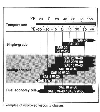

As for low grade synthetic oils not being suitable here is what my 944 manual says.
Firstly the manual lists the different oils to use at differing temps, it lists single grade oils (Listing SAE 30,40), Multigrade oils (listing SAE 20W-40 - 15W-40 - 5W-20, etc) and Fuel Economy Oils (Listing SAE 10W-30 5W-40 and 5W-50 for temp range from -30 to +40C)
Then later on the same page in the text headed 'Fuel Economy Oils' it says;
'Fuel economy oils require low viscosity at low temperature and high thermal stability at high temperatures. As high-performance oils, these oils are manufactured only as synthetic or hydrocrack oils at present. On account of their low viscosity, these oils are also fuel economy oils and are termed "all season fuel economy oils" in the Porsche Approval.'
So it appears that synthetic oil was recommended in my Porsche 944/944 Turbo manual (May 1988) and it is clear to me that Porsche approved this so called all season fuel economy oil (due to its large viscosity range and improved fuel economy), that is also states was only available as a synthetic or hyrocrack oil.
So far from being unsuitable it would seem that synthetic oils, including those in the 5w-40, 5w-50 range are suitable for the 944 engine and were actually approved by Porsche.

I think you are missing the point here slightly, no one is saying they bought a porsche 944 Turbo for good fuel economy. The manual is simply stating that if you use a good synthetic oil such as 5W-40 the low viscosity reduces drag on the engine and therefore improves fuel economy. I think any efforts to be more fuel efficient are worthy whatever size or type of car you drive.
At the same time the manual is stating that low vicosity synthetic oils are suitable and recommended for the 944 which seems is the opposite to what some are purporting to be the case.
As far as I recall: and as far as I can see now, Porsche only 'recommends' 5W- oils where the vehicle is being operated in enviroments which reach -30c and never even approach freezing.
Porsche recommends in the manual to use 5W-40 and 5W-50 in the temperature range -30 - +40 (the whole of the temperature bar at the top of the graph).
I can provide a scan of the manual if this would help...

Here you go.
Notice that they put these oils in their own little section titled Fuel Economy Oils. Nobody wanted to use them much in reality, but you could use them though they're not ideal. I know I won't convince many who want to use these oils. Luckily we live in a free part of the world. All I can say is that you and I might theorise, whereas people like Bruce Buchanan is a Porsche factory trained mechanic and was close friends with Klauss Kessner (sp) who was one of the Porsche engineers. Neither has any doubts over the matter. You will open your engine up to the possibility of increased wear or worse by using some of these oils. Even the ones that the Porsche factory recommended.

This graph is Porsche Recommeded oils, and yes they ARE ALL ideal as that is why porsche is recommending them. They have there own little section because they are high performance synthetic oils (porsches words not mine) and have a high temperature range that enables them to be used in all seasons. They are also more fuel efficient due to less drag on the engine.
Read the text under 'Fuel Economy Oils'
Says it all really.
In our climate with our average temps Porsche specified 15w and 20W generally.
0` 5`s and 10`s are for Russia in the winter as the low numbers are due to extreme cold so thin oils are only needed for startup protection in cold climates and will run off the engine parts and wont offer the bulk protection on start up of higher numbered oils in warm climes.
This will also be true of higher tolerances/gaps as the engine wears (as I keep saying) [;)]
I think perhaps it appears slightly confusing for some the way porsche has listed the wide viscosity range oils as 'Fuel Economy Oils', replace 'Fuel Economy Oils' with 'Synthetic Oils' (as stated on the same page that this is what Fuel economy oils are) on the graph and it reads somewhat differently.
