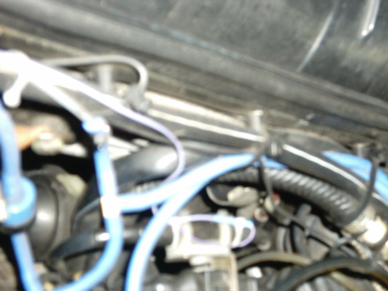

The lambda plugs in on a bracket at the back of the inlet manifold.
If you don't have a lambda probe you will have a blanking plug, like Beaky used to have.
What do you mean by used to have? Have you retrofitted the Lambda probe for some reason like fitting a Cat to a non-Cat car?

As Tony suggested, I fitted a Porsche lambda probe to provide a signal for my narrow band AFR gauge. My thoughts were that it fitted properly and, by using the existing loom, meant I didn't have to drill holes through the bulkhead. It does mean that you have to intercept the wires on the big multi-pin plugs going into the DME and KLR, which can be a bit entertaining though.

Pardon my ignorance, but I'm assuming this is a Lamba probe rather than a blanking plug and annoyingly I'm with Cat?
looks like the blanking plug is it just a loop?
for probe cable plugs into the same socket and dissapears down towards the exhaust in the turbo area.
Tony
Yes, poor pic but it's a single loop and nothing heading downwards. Good news then!
