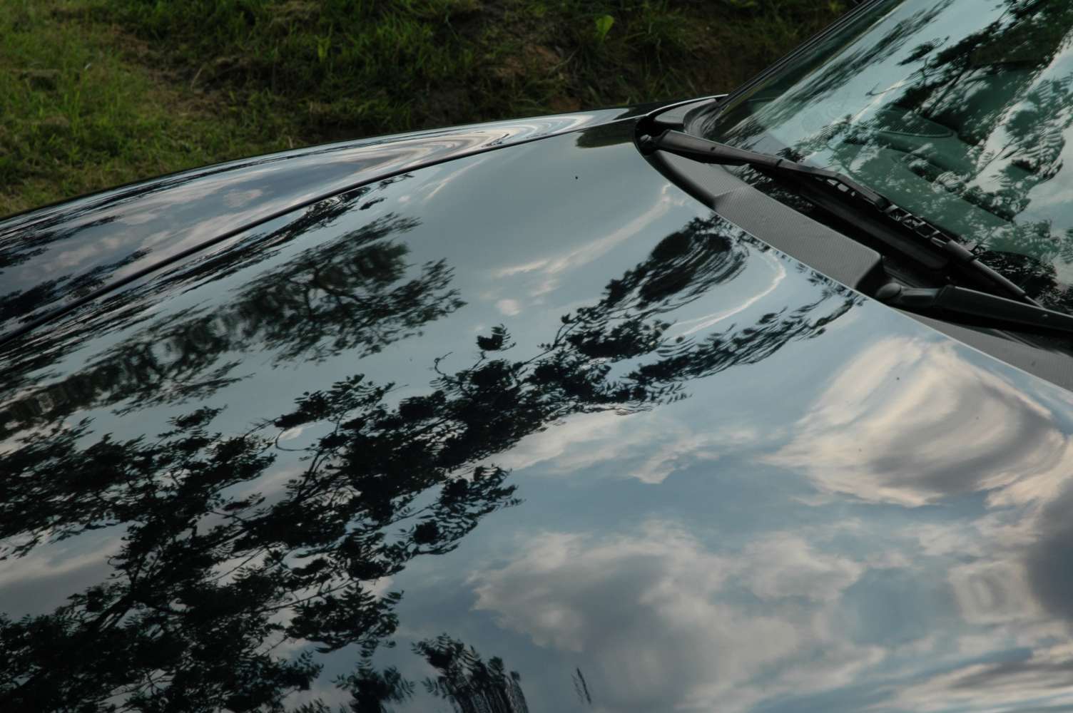

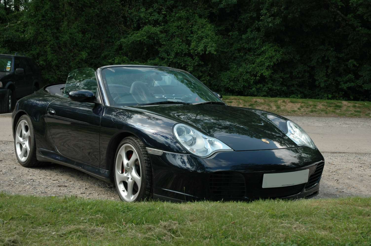

Glad to oblige re pics [:)] Here is no:1
Wow - looks good. How long do you think it would it take a Zymol novice to get that result and how much would he need to invest in the starter kit?
Took me about 4 hours... but I was cramped up in the garage.[&:]
Not bad for a 17 year old car!
I washed with clear, then klayed her, a scrub with HD cleanse and IIRC she had 3 coats of carbon
