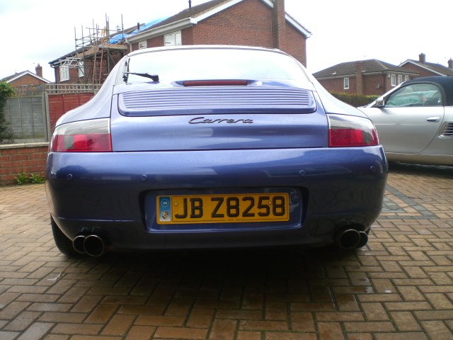

My 996 C2 in Zenith Blue looks the same age as yours (1998) and mine has the clear light cluster (on the car when I bought it 3yrs ago).I have also fitted the blue headlight bulbs and people ask me if I have fitted a xenon kit.
I must admit it looks quite good - especially now I've resprayed the front end of stone chips and fitted the chrome mesh on the grills
John
Excellent. I think there are more of us with early cars zenith blue than I first thought. Up to 105 k now. What are you up to?
89k so far but I've only had it 3 years
It's just a weekend "toy"
I was going to sell this year for a 997 but after having the front end repsrayed of all stone chips and wheels refurbished I don't want to get rid of it now.
I also fitted rear parking sensors but couldn't find the right colour
Had them coloured when I did the front end and looks the business from all angles now
Also have s/s exhaust manifolds and silencers, along with twin tailpipes
