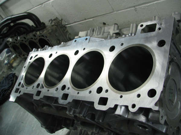

Thought I might as well throw a few pics your way gents. The engine is pretty much ready to go into the car now. At the last minute, as in last week, we have decided to go for a full LINK G3+ standalone system so now have to wait on some components to arrive and will install them before the engine goes in, just for better access. The work is a collaboration of Dave McGrath's who has appeared on hear briefly as Evil 944t and Neil Harvey of Performance Developments, a Kiwi who is residing in California now, ex of the UK when he worked with some unknown bloke called Gordon Murray during the all conquering Brabham BMW turbo days of the 80's. As you can see the workmanship of the deckplate is top notch.

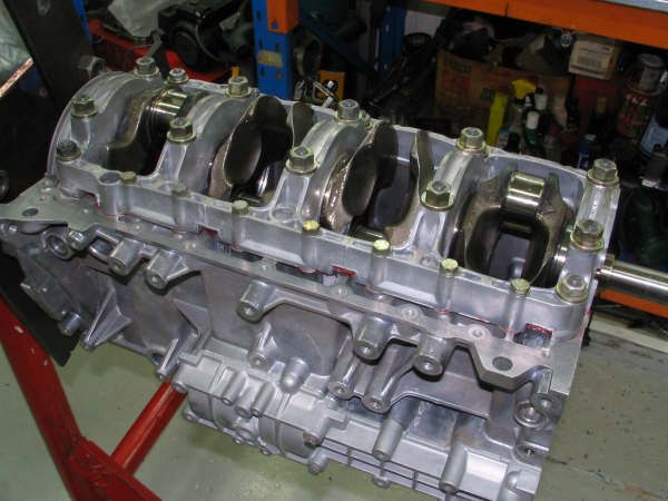

3.0L knife edged crank into the girdle that has been line bored and pinned for extra structural integrity.
I always think these things are a work of art. It's a shame they are hidden away once up and running.

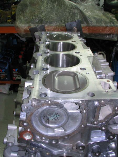

Your block looks different Patrick. I know you said you are using dry liners but from other similar shots of wet lined blocks you see the liners with the holes which appear to be sat in a pocket so the top rim of the liners are exposed. Does you 1st photo have the HG in place or has this pocket been filled in?

No what you see is the deckplate. It has been designed and fitted to surround the cylinders and work with the Darton dry sleeves. It's probably about 5mm thick and it looks factory fitted so good is the machining. I have some bigger pics that you can really see the detail, but too large to load up here. When we first saw it, we told them that we weren't going to install it as it was too beautiful. Instead we would leave it in it's special wooden crate only to open it up for special occasions accompanied by singing heralds and a Golden light emanating from within!! Haha, in other words you're right, it's a shame to have to install them.

I can just see the different shade of the deckplate in the top RH corner of the first pic, it almost loks like a solid top. You must tell us how the fit of the SFR exhaust manifold is on a RHD car as I know they have previously only made them for LHD. Please post more details as soon as it's fitted and running [8D]
Yes the deckplate is really clean. As I said it really does look factory. The 5" is probably overkill for this engine but we have something else in the pipeline that will probably go in next year so why do it again. There are reports that after 450whp (approx) you really benefit from a larger than 4". We are doing an ovalised 4" section from the CAT back to past the axle for clearances, then out to 5". It is going to look pretty ricer as they say in the US.

Patrick sent me some bigger pictures which I've uploaded to photobucket and posted here. You can clearly see the slightly lighter shade of the deck plate between the cylinders and the block itself. I believe the idea is it holds the cylinders firmly in place, which allows the head gasket to make an even better seal than normal. The standard cylinders are 'loose' in the water jacket and will move very slightly under load.
I see, however what was in the cavity that was there before? I had always imagined it to be part of the cooling system where the coolant would be pumped through?
The cavity was full of coolant, and it still is, only now there is a 5mm thick lid at the top with holes for the coolant to flow through.
