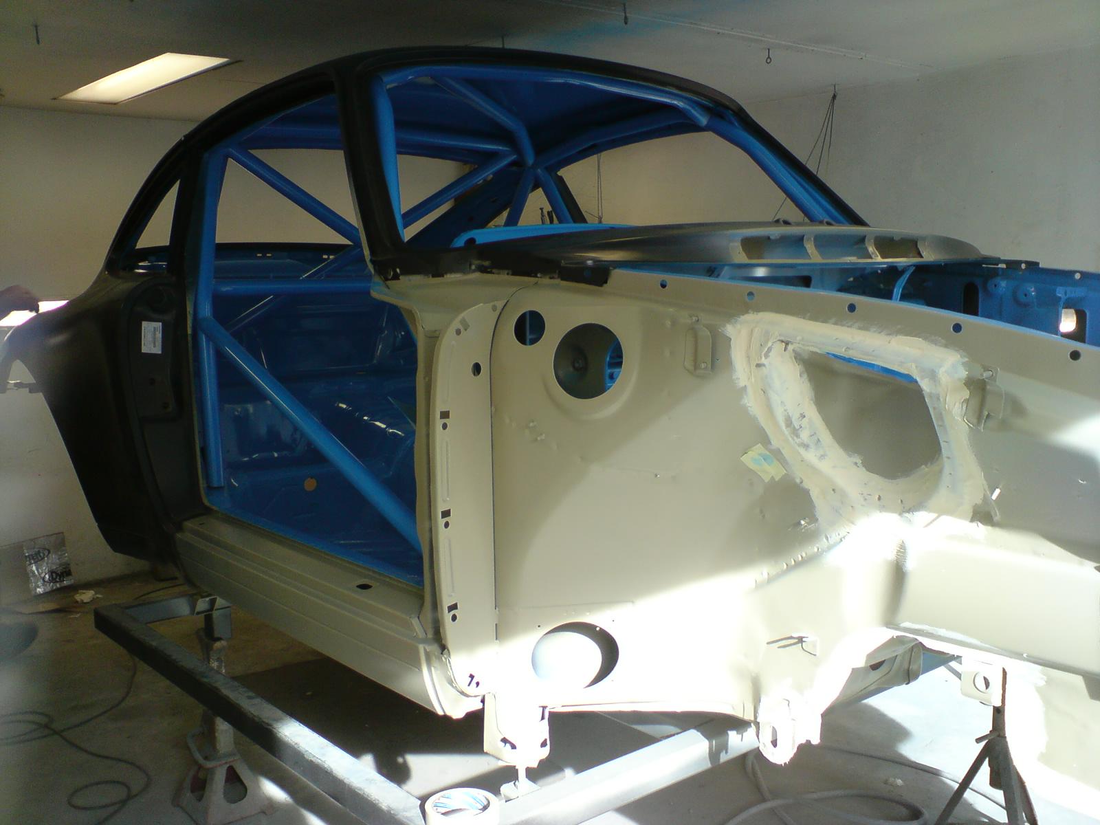

Thought I'd update you gentlemen. The car is progressing nicely and is now in full paint with cage fitted and seam welded where appropriate. Suspension has been shot blasted, sperical joints fitted along with solid subframe mounts and every nut and bolt replaced. Basically the suspension is now full cup spec. Looking forward to getting out in it and working on the set up

That top photo is one for clubsport, I am assuming the car is RHD? my RHD car has the M003 cage in but with the roof diagonal going the opposite way, same as in a LHD car. Makes sense the way your cage is set up.
Great minds, Mike....[:D]
That was the first thing I noticed too!

Thanks for the response - wasn't looking at building a true rep - just thinking along the lines of cage, sunroof delete and a bit a seam welding to stiffen up the chassis. Mines more a long term project :)
Dont understimate the effort of doing the cage. As the cage on the 64CS goes through the rear bulkhead down to the suspension mounts, its not an easy thing to do. So once you've committed to doing that properly and the seam welding, its not so much more to finish the job off right as Steve says.
