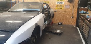

My Attempt at a metal wide body build

Thanks stay tuned it will be a good 12months work

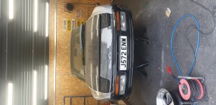

Amazing work - maybe you should fit some turbo fans on the wheels - would look proper cool with the wider arches too....
I'm using early offset Fuchs alloys 17" same size as standard car but the early offset pushes them out extra 23mm or so

not sure about those wheels I think I’ll stay with me Fuch’s - but I do like the rear spoiler

It’s back on wheels -early offset but not the ones I will be using

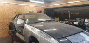

all the welding and rust repairs done

So thought long and hard how to do the sunroof delete
the correct way is to replace the roof skin but I didn’t feel confident in removing one from a donor car and welding it back on without distortion.
carbon fibre - maybe but expensive and some skill needed
the fibreglass plug seemed the best option but didn’t really want fibreglass on the roof as that can get very hot and with Expansion may be visible.
cutting a panel from a donor and swaging the edge was a possibility but would require removing all the sunroof support and cutting the flange from the roof skin but then needs tig and skilled welder to get in without distortion.
so I did it my way first brought a 924 roof from eBay £150 there seems to be a few about cut the bit I needed 10mm oversize
Templated the roof and cut some jigs 500mm long that matched the roof shape i used these to clamp the panel so it wouldn’t distort.
with the panel clamped I was able to tap down the edge creating a steel version of the fibreglass plug
