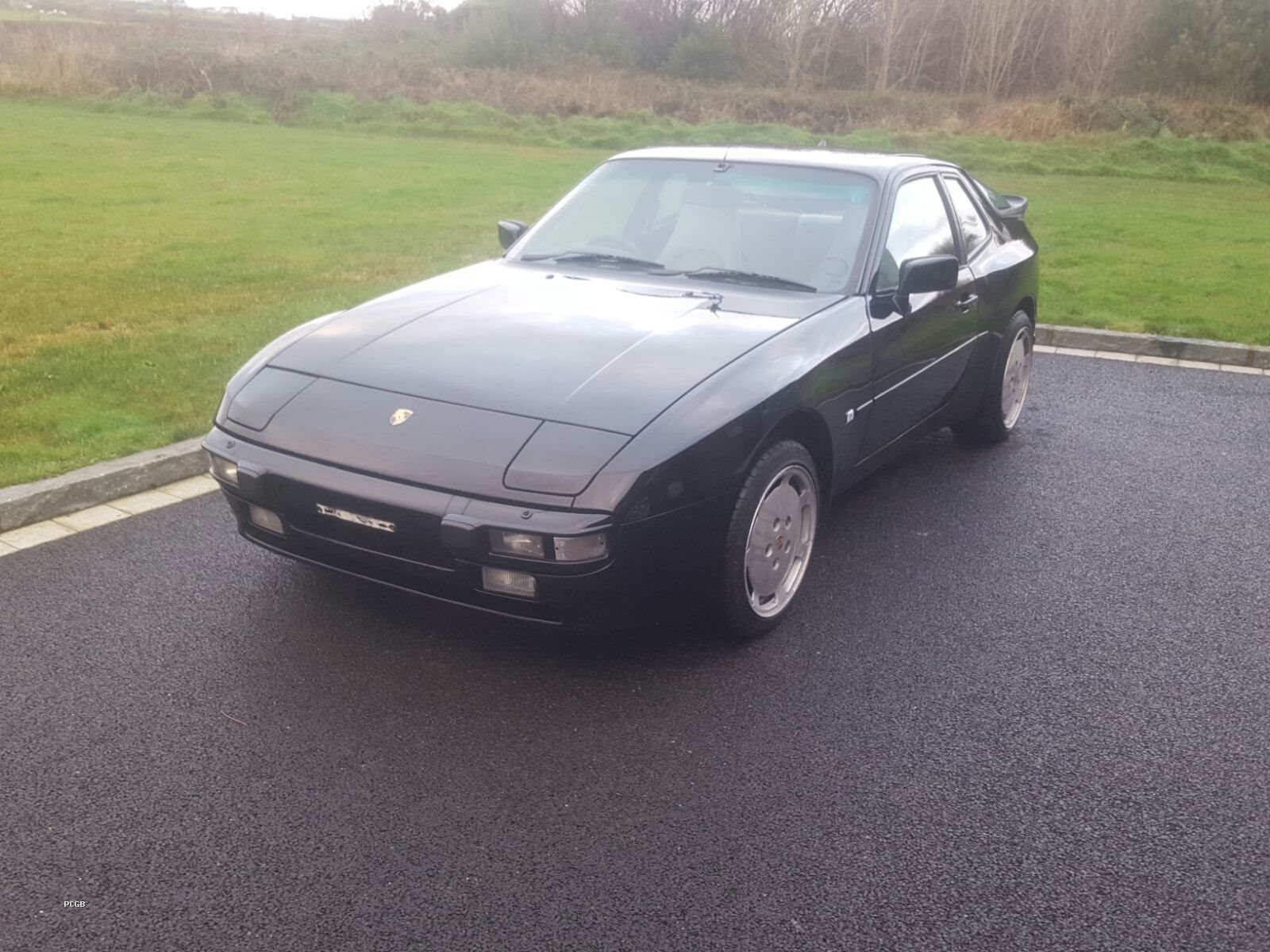

Yes, I know the wheels are off a cayenne, maybe I'm just used to newer cars but it seems to like to tram line a bit... the wheels don't go straight with ease over slightly indifferent surfaces. There's no play in the steering or anything, reminds me of my old mk2 golf that had 8" wide wheels. There is the odd squeak out of the belt when maneuvering, but it had sat for nearly 2 years. Does the PS fluid require a change too you think?

Yeah I was going to get a lend of those from a friend but he got offered strong money for them so he sold them. I'll have to hunt myself, would love something that'll fill the arches up rightly. He has 928s on his and put 30mm spacers on too and it sits beautifully, although he is to lower it a bit... you can imagine

[attachImg]https://www.porscheclubgb.com/forum/download.axd?file=0;950484&where=message&f=IMG-20170104-WA0005.jpg[/attachImg]
For best handling, feel and steering whilst your in the car driving it! ...stick with the Original sizes and offsets ,
If your prefer to change the car and achieve a certain "Look" when your out the car looking at it (Not driving it!) and / or other people are "looking" at it
change it, space it, do you what you wish etc...but there will be compromises to the handling, ride and steering feel.
Those forged 928 wheels are also quite light, but that Look is gross for me, all wrong and will not drive as nice as it could, each to their own!
The tyre look like a narrow tyre on a wide rim (stretched) in this photo?
R
yeah he has the tires stretched on it, he swears it doesnt handle any different for all he drives it.
He uses that as a daily but has a lovely s2 locked away that he dotes over...
