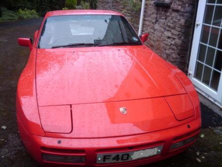

In the meantime, here's a few pics.
Hmm, I get a message saying only one image per post....how do people upload multiples??
