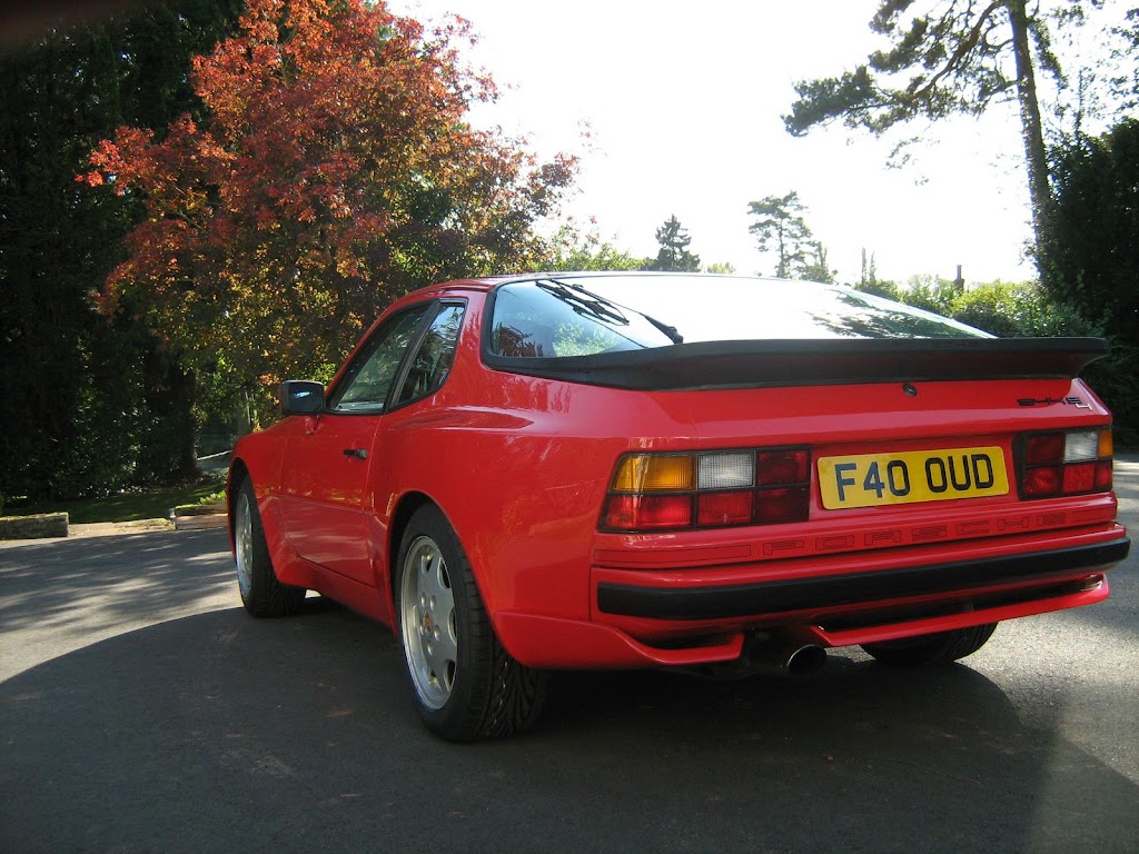

Here's some pics after giving it a first wash and after fitting seats and harnesses.
Yeah, I am SO curious about previous owners. Someone must have enthused about it and put little details like the S4 logo on it (I'm keeping it for the day when I fit the V8 i.e. 2x4 cylinders!!). Any one recognise this car? By non matching interior are you referring to the seats or the roll cage?!![;)]
ORIGINAL: blease
All of them!
I can almost (almost) understand sticking a turbo badge onto a non-turbo, but sticking badges on to make it look like a model that never existed ... odd.
Oli.
You're right. It's just such an odd thing to do. Along with the 8J wheels on the front, I wonder what other non-spec 'enhancements' I will find? She pulls so well I wonder whether she has been chipped already.
