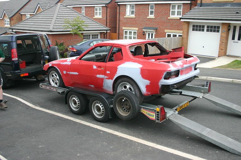

I'm having a respray at the moment and have done all the prep work myself to keep the cost down, being a lux I couldn't justify spending a fortune on a respray when the finished car is only worth 2K tops. My respray should come in around £500. The only glass to take out are the rear windows, the fronts just wind down out of the way, rear hatch is 4 bolts to remove plus struts and electrics. The front screen can be left in with just the seal removed. If you do the donkey work like removing the mirrors, door handles, trim pieces & bumpers etc you should be able to save a fair amount on the cost.
You mention peeling laquer, I was under the impression that there shouldn't be any on a guards red car, although I stand to be corrected.
